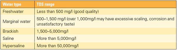

Table 1. Water quality definitions by TDS level. Source: China Water and Rivers Commission, June 2000
Given the interest of these delta regions in developing marginal water resources, a new category of supply water was established. The high-salinity water supplies that lie between freshwater (less than 500 mg/l) and standard seawater (35,000 mg/l) is called "sub-sea" water.

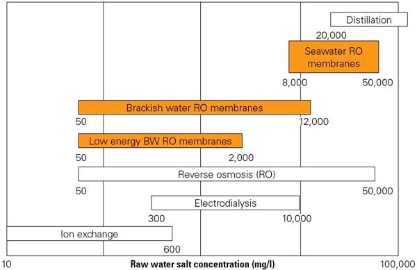

These salinity fluctuations render traditional ion exchange (IX) water treatment processes incapable of stable and reliable operation. Typical IX processes have a very narrow TDS operating band of 10 mg/l up to perhaps 600 mg/l. Reverse osmosis (RO) technology has successfully treated brackish water with salinity in the range of 1,500 mg/l to 5,000 mg/l with high salt rejection (SR). IX also suffers from other operational drawbacks, such as using acid and caustic chemicals for resin regeneration and post-treatment of those wastes, more water for regeneration, and a large area of plant floor space. As a result, RO is now the favored technology in 90% of Chinese industrial desalination plants (Figure 1).
1. Processes for treating water. Main desalination processes. Source: Dow Chemical
