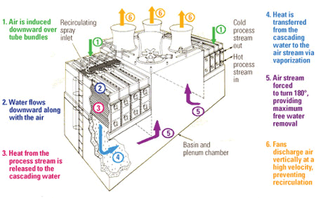

The basic operating principle of a WSAC is rejection of heat by evaporation. The fluid/vapor to be cooled or condensed flows through tube bundles in a closed-loop system. A large quantity of water (generally 7 to 10 gpm/ft2 per coil face area) from the unit basin is sprayed downward over the tube surfaces (Figure 1). Simultaneously, fans induce air flow over the bundles in a co-current direction. Evaporative cooling takes place at the exterior tube surfaces. The saturated air stream leaving the tube bundle then makes two 90-degree turns into the unit’s fan plenum. The reduction in velocity returns almost all of the large water droplets to the basin. The air is then discharged out of the unit through the fan stacks.
1. Go with the flow. The co-current flow of air and water in a wet surface air cooler increases the system’s heat transfer efficiency, reduces scale deposition on active surfaces, and virtually eliminates drift of water droplets into the environment. Source: Niagara Blower Co.

The co-current flow of air and water creates an unobstructed spray system that is fully accessible for observation and maintenance. Another plus of the design: Because the air passes over the water in the system before and during its contact with the tube bundle, the mixed water temperature remains above freezing. This protects the tubes from freezing even when the ambient air temperature is below zero. The co-current flow also ensures complete coverage of tube surfaces (there are no bare spots, as seen with counterflow designs), reducing further the potential for fouling and freezing.
