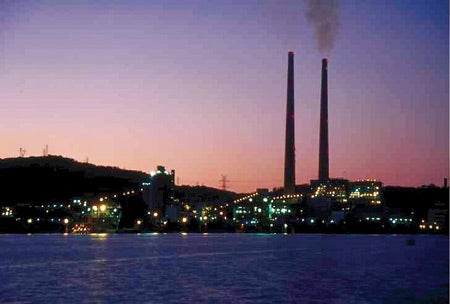

About two years ago, Jeff Gremelspacher —then chief chemist at Cardinal Generating Station in Brilliant, Ohio—was asked to evaluate potential replacements for the chlorine gas disinfectant system serving Units 1 and 2. The system was used to prevent the formation of microorganisms in the Ohio River water pumped through thousands of 1-inch-diameter cooling tubes in the 600-MW unit's steam condensers. Unit 1 (Figure 1) is owned by American Electric Power (AEP); Units 2 and 3 are owned by Buckeye Power, a generation and transmission cooperative established by Ohio's rural electric co-ops. Cardinal Operating Co., co-owned by AEP and Buckeye Power, operates all three units of Cardinal Generating Station.
1. Fighting bio-growth. Units 1 and 2 of Cardinal Generating Plant in Ohio use an automatic vacuum dosing chlorination system from Portacel Inc., a unit of the Aquious division of ITT's Advanced Water Technologies Group. Courtesy: American Electric Power
