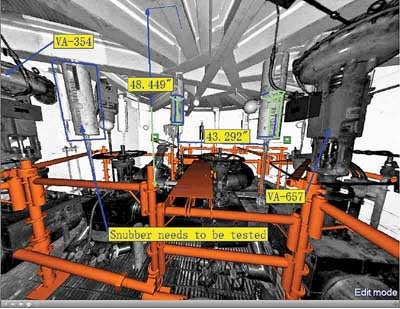

1.    Digital diagrams. A laser scan of a typical equipment room can be supplemented with scaffolding, dimensional data, and components to be removed, thereby serving as part of a comprehensive overhaul or replacement planning tool. Source: CSA Inc.
Laser scanning also provides a dimensionally accurate representation of the plant and all its equipment as well as a photographic quality visual representation. The laser scan database can be integrated with a variety of plant design applications to provide comprehensive facility management support.
In fact, a laser scan 3-D database can be combined with the 3-D CAD tools now becoming more common to develop a comprehensive representation of a facility. This virtual view of a plant can now be used to explore alternative equipment removal evolutions, scaffolding management, or rigging sequence planning and training. It can even be integrated with other radiation-monitoring technologies. Also, for a nuclear plant planning an outage, complete equipment removal and replacement simulations can be performed to identify construction and access problems when they are easily resolved, rather than when a hole is open in the containment building.

The next step is to merge the simulated equipment path within scans and generate a new set of scans that represent the merged equipment simulation sequence. These scans can be reviewed within PanoMap — a laser scan 3-D viewer, part of the Laser Scan Space Manager (LSSM), which is a module of this case study plant’s overall plant configuration management system — or Plant/CMS, which provides intelligent 3-D technology for large-scale plants. Within Plant/CMS, the removal path sequence can be reviewed and adjustments to the path can be made. Based on these adjustments, some of the steps will need to be reprocessed.
Using PanoMap, the user can review the equipment’s movement process through all the scans. Notes, labels, and instructions also can be placed in individual scan views. Additionally, any electronic drawings, procedures, photographs, or documents can be hyperlinked to the scans (Figure 7).
