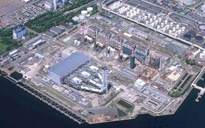

1. Reduced footprint. The new combined-cycle plant that is shown on the left side of this aerial photo occupies only one-third of the facility’s 3,000,000 square feet. The existing six-unit conventional steam plant is shown on the right. Courtesy: Tokyo Electric Power Co.

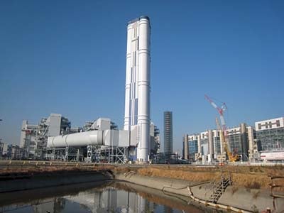

Group 1 was constructed as a liquefied natural gas (LNG)–fired facility equipped with three 500-MW single-shaft combined-cycle plants, for a total of 1,500 MW. In addition to power generation, this new plant was configured to supply steam from the heat-recovery steam generators (HRSGs) to 10 neighboring industrial facilities. This higher efficiency steam supply allowed the elimination of lower efficiency old boilers, which were located in nearby facilities, resulting in significant energy savings and emissions reductions (Figure 2).
2. Exhausting work. A common exhaust stack is used for the plant’s three combined-cycle blocks. Courtesy: Tokyo Electric Power Co.
