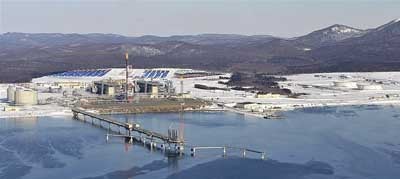

Offshore liquefied natural gas (LNG) suppliers are satisfying the difference between rising demand and declining U.S. domestic production of natural gas and Canadian imports. For example, Gazprom and Shell announced in April that LNG from the Sakhalin-2 project, located off Russia’s eastern coast, will enter the U.S. market through the Energia Costa Azul import terminal in Baja California, Mexico, and eventually make its way into Southern California. The Sakhalin-2 project is expected to produce about 5% of the world’s LNG next year (Figure 1). Although access to new supplies is a good development, Siemens’ research has indicated that the composition and hydrocarbon content of imported LNG can significantly vary from current domestic sources and may cause operational problems.
1.    East meets West. The first Russian LNG plant on Sakhalin Island consists of two process trains, each having an annual production capacity of 4.8 million tons. The plant is projected to reach its design capacity (9.6 million tons per year) in 2010. Courtesy: Gazprom
