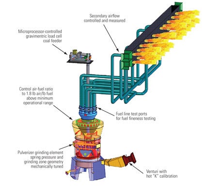

Injecting the correct mixture of air and suitably prepared coal into the furnace in the right amounts, in the right location, and at the right time is the key to optimizing boiler efficiency, reliability, fuels flexibility, maximum capacity, and low stack gas emissions. This sounds easy in theory, but it’s much more difficult in practice given all the seemingly uncontrollable variables in the process.
However, pulverizer and related problems lend themselves to a structured analysis approach. There’s an old proverb that asks, How do you eat an elephant? The answer: One bite at a time. The same wisdom applies to a pulverizer tune-up (see sidebar).

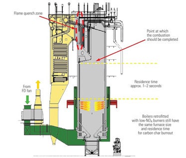

Figure 2 shows the burner belt and furnace of a typical boiler and illustrates the short residence time, typically less than two seconds, that a coal particle has to complete combustion before impinging, and perhaps sticking, on a superheater or waterwall tube. If that particle continues to combust in the backpass, boiler efficiency is reduced, slagging and fouling increase, upper furnace gas temperatures are elevated, and emissions may increase.
2. In the zone. A fuel particle has less than two seconds to complete combustion before entering the superheater section of the boiler. Source: Storm Technologies Inc.
