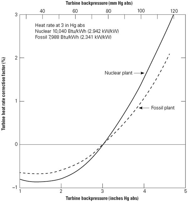

As you will see shortly, the effect of condenser water inlet temperature is strongly influenced by the shape of the "turbine backpressure curve," as shown in Figure 1. Note that the smallest incremental improvement occurs at the lowest backpressure, where the curve is reasonably flat. Conversely, the greatest incremental improvement will occur at the higher condenser inlet water temperature conditions. Therefore, fossil and nuclear plants experience the greatest benefit of reduced condenser water temperature in the summer months during peak demand season.
1. Changes with temperature. This turbine heat rate correction factor curve specifies 3 in. HgA as the standard performance condition. A turbine heat rate factor must be applied when the turbine backpressure changes as a reaction to condenser cooling water temperature changes. Note the differences between the response of a typical fossil and nuclear plant. Source: Dr. Ralph L. Webb
