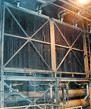

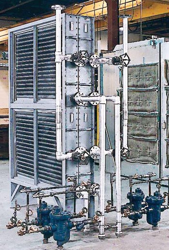

Figure 1 is a very simplified schematic of a SCAP. Most units use vertical finned-tube coils embedded in perimeter entry walls to connect to the suction side of a forced-draft (FD) fan or fan room —the source of combustion air. Some SCAPs, however, are designed to be installed on the discharge side of the FD fan, between the fan’s ductwork/transitions and the duct connection to the inlet (cold end) of an RRAH. As opposed to being bolted in place by duct flanges (Figure 2), units used in such a configuration are usually drawer-mounted, for easier access and removal (Figure 3).
2. Bolted in place. A wall-mounted steam coil air preheater with common receiver drainage. Courtesy: Armstrong Heat Transfer Group
3. Easier to replace and maintain. A pre-piped, duct-mounted, drawer-type steam coil air preheater with individual coil trapping. Courtesy: Armstrong Heat Transfer Group

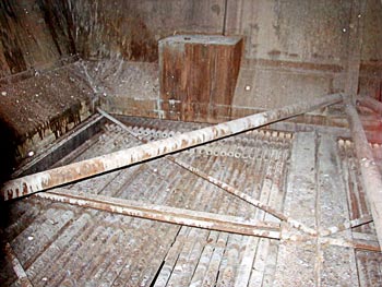

Placing a SCAP ahead of the cold end (inlet side) of a RRAH, however, can invite maintenance problems and shorten unit life. For example, if a SCAP is placed directly below an RRAH, corrosive sediment and crud dislodged during basket washdown will fall onto coil-finned surfaces and accumulate there (Figure 4). Clogging and reduced performance will be the undesirable outcome. Often (but unintentionally), the SCAP’s coils serve as a convenient platform for maintenance workers tasked with cleaning and inspecting the RRAH.
4. Look out below. Because this steam coil air preheater (SCAP) was mounted directly below a rotary regenerative air heater, corrosive sediment and crud dislodged during RRAH basket washdown fell onto the SCAP’s finned-coil surfaces, damaging them. Courtesy: Armstrong Heat Transfer Group
Another undesirable consequence of placing a poorly constructed, specified, or drained SCAP just upstream of the cold side of an RRAH is the development of steam and/or condensate leaks in the air stream. This can lead to evaporative cooling of the RRAH’s surface, which “steals” valuable energy from the unit. All three of these SCAP-related problems—increased maintenance requirements, shortened life, and higher-than-necessary energy consumption—have been reported by large fossil fuel–fired power plants in the U.S. and Canada.
