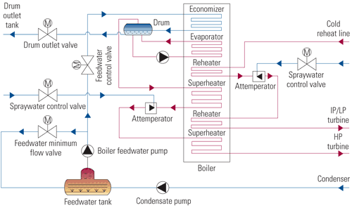

Desuperheaters—often called attemperators—in heat-recovery steam generators (HRSGs) are located between the primary and secondary superheaters and reheaters, and sometimes after the final stage of superheating (Figure 1). They are responsible for controlling steam temperature in accordance with start-up and steam-turbine-inlet requirements. The attemperators also prevent thermal damage to superheater and reheater tubes, and to outlet steam piping and downstream equipment.
1. Where you'll find them. Attemperators for heat-recovery steam generators (HRSGs) are located between the primary and secondary superheaters and reheaters, and sometimes after the final stage of superheating. Courtesy: CCI International Ltd.
Interstage attemperators for superheaters typically see pressures up to 1,900 psig, temperatures to 1,020F, and steam flow rates to 660,000 lb/hr. Reheater attemperators experience similar temperatures and flow rates, but pressures normally go to only 450 psig.
