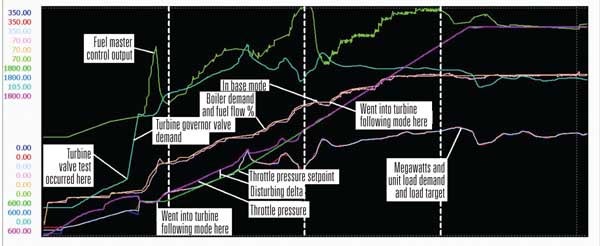

Figure 2 plots the data taken during start-up of a 320-MW power plant. At the lower left corner you can see where the valve transfer occurred. The valve transfer is a process in which the turbine, upon start-up, transfers control from the stop valve to the governor valve. There are actually two sets of valves in the main steam line before the turbine: the main stop valve and the governor valves. The next interesting point on this figure is the area that I call the "disturbing delta." There was a long period, during this load ramp, when the difference (delta), between the throttle pressure and the throttle pressure setpoint was virtually constant (the purple and green lines at the first vertical white dotted line). When we expect the controls to act one way, and they do not, it’s time to investigate.
2.    Under control. Taming a control loop that switched out the integral control on a load ramp. Source: Tim Leopold
During a change in unit load demand, in coordinated control, it is common practice to decrease the integral action of the boiler master controller to zero until the load ramp is finished. This strategy was used in all of the turbine and boiler master controller modes. This is a case where more is definitely not better; there was a touch of feedforward, based on boiler demand, substantial proportional gain, and no integral gain when I looked at the logic. Tuned as it was, the error signal between throttle pressure and throttle pressure setpoint will never go away.
I tried to tune out the error without success. Although the error decreased, as shown in Figure 2, we soon discovered that the tuning was not robust under all operating conditions. We then downloaded the necessary logic modifications (the second white vertical dotted line), causing the unit to drop out of turbine-following and into base load mode, and then back again. When the logic modifications were made, from that point on (the third white vertical dotted line) you can see good control of the throttle pressure. This is how a well-tuned turbine-following mode should operate.
