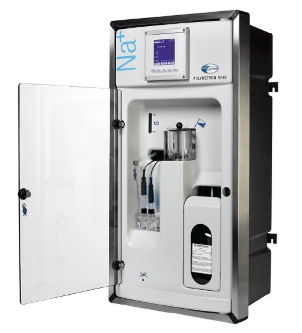

Steam passing through the turbine (preferably sampled at the reheat steam sample station after attemperation) should contain less than 2 ppb of sodium and have a cation conductivity of less than 0.2 microsiemens/cm (Figure 1). These two critical parameters need to be continuously monitored and displayed and alarmed in the control room. The limit of 0.2 µS/cm of cation conductivity can be affected by the presence of organic acids and carbon dioxide in some units (see sidebar).
1. Measuring sodium. Measuring the sodium content of water and steam in modern power plants is critical; however, measurements are problematic. Modern analyzers, such as the Hach Model 9245, can detect levels of sodium down to 0.01 ppb. Courtesy: Hach USA
