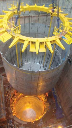

Five reactors, of both indigenous and foreign design, are under construction, including a 500-MW prototype fast breeder reactor. That project, which is being built at Kalpakkam, near Chennai, in Tamil Nadu state, was expected to come online at the end of 2010, though it could be delayed a couple of months or up to a year, an unnamed source told the Business Standard in February. The delays are being blamed on the lengthy commissioning of equipment that is "being made for the first time," the source said. The main vessel was recently installed at the project, which is being spearheaded by federal research enterprise Bharatiya Nabhikiya Vidyut Nigam (Figure 1).
1. Fast and furious. This 500-MW prototype fast breeder reactor is being built at Kalpakkam, in Tamil Nadu state, by federal enterprises Bharatiya Nabhikiya Vidyut Nigam (BHAVINI), Indira Gandhi Centre for Atomic Research, and the Nuclear Power Corp. of India. On Dec. 5, 2009, the stainless steel main vessel was lowered into the safety vessel. The main vessel—12.9 meters in diameter, 12.94 meters high, and weighing 206 metric tons—will house the third and smallest inner vessel and associated components. The project has reportedly been delayed; it will now come online in 2011. Courtesy: BHAVINI
