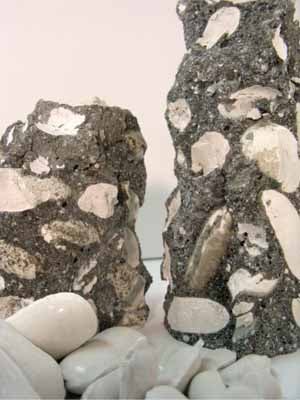

Another company engaged in recycling CO2, Calera Corp., was called out in a March Thomas Friedman New York Times editorial. Calera will receive $1,681,377 in DOE ARRA funds. In December, Calera Corp. and Bechtel Power Corp. announced an alliance in which the two companies will develop and build facilities using Calera’s patented process to repurpose CO2 emitted by coal- or gas-fired power plants. The process captures CO2 from raw flue gas in water and then converts the GHG into calcium and magnesium carbonates for use in manufacturing carbon-negative products such as sand, aggregate (Figure 4), supplementary cementitious materials, and cement, as well as freshwater.
4.    From gas to solid. This sample of supplemental cementitious material (SCM) blended with portland cement and Calera aggregate uses CO2 recycled by the Calera process. SCM is used to replace cement in concrete mixtures. Each pound of cement replaced with Calera SCM means 1.5 pounds of CO2 not released to the atmosphere. Courtesy: Calera Corp.
