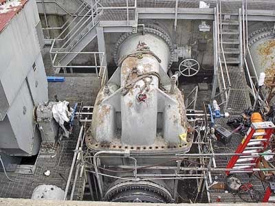

Circulating pumps at the coal-fired facility were to be converted to mechanical seals from traditional packing to prevent wear on pump shafts and better control leakage (Figure 5). Over time, traditional packing caused wear on the pump shaft because there was contact while the shaft was rotating. The packing then required frequent maintenance — either adjustment and/or frequent replacement — so the pump could achieve maximum efficiency without reduction in head. Converting the pumps to mechanical seals was expected to extend mean time between pump maintenance schedules and provide for more trouble-free maintenance.
5. OK pump needs work. A power plant located in Oklahoma decided that upgrading its circulating water pumps to mechanical seals would be less expensive than replacing sleeves and shafts. Courtesy: Climax Portable Machine Tools
