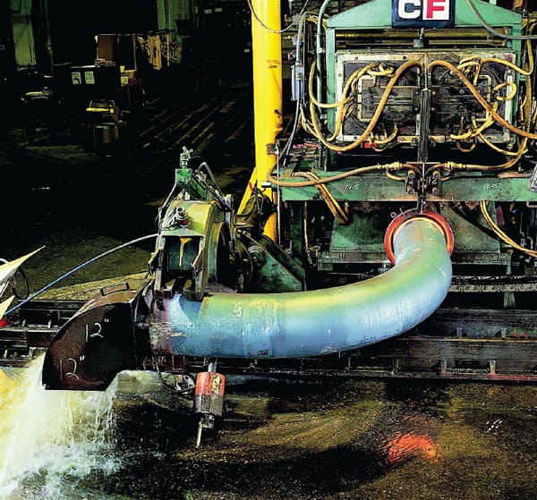

However, one type of pipe promises to deliver the best of both worlds: an induction-hardened pipe with an abrasion-resistant inner surface that tapers to a strong, yet ductile outer surface. Ultra 600, manufactured by Port Washington, Wisc.–based Ultra Tech begins with a steel pipe manufactured to a proprietary chemistry, followed by induction heating and water-quenching of the inner surface to create a single-wall pipe (Figure 3).
3. Best of both worlds. Ultra Tech begins the manufacturing process with a steel pipe manufactured to a proprietary chemistry. Next is induction heating (as shown in the photo), which is followed by water-quenching the inner surface to create a single-wall pipe. At 600 BHN, the inner surface of this induction-hardened pipe can withstand most common abrasives. A 250 BHN outer surface is ductile enough to endure normal handling during shipment, installation, and maintenance. Courtesy: Ultra Tech
At 600 BHN, the inner surface of this induction-hardened pipe can withstand most common abrasives. The pipe tapers to a 250 BHN outer surface that is ductile enough to endure normal handling during shipment, installation, and maintenance. With this proprietary process, pipe can be manufactured in various diameters up to 40 inches and in varying lengths and wall thicknesses. The pipe can be cut and welded like mild steel and accepts standard end options of flanges, weld rings, and couplings (Figure 4).
