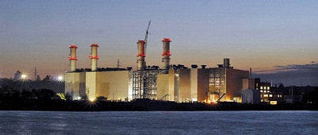

Port Washington Generating Station (PWGS) is two for two. Phase 1, placed into commercial service in July 2005, was a POWER Top Plant. So, too, is Phase 2, the second 545-MW power block of We Energies’ PWGS, located on the shore of Lake Michigan. Phase 2, which entered commercial service on May 23, 2008, after successfully completing its final testing activities, effectively doubles the plant’s output to 1,090 MW (Figure 1).
1. Siamese twins. Unit 2 of the Port Washington Generating Station rises next to Unit 1, which was completed by URS Washington Division’s Wisconsin Power Constructors in 2005. Phase 2, using a virtually identical design, entered commercial service in May this year. Courtesy: URS Washington Division

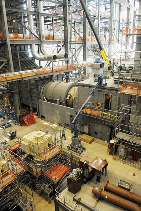

Phase 2 of this project is a gas-fired combined-cycle plant powered by two General Electric 207FA gas turbines, each exhausting into a three-pressure heat-recovery steam generator (HRSG) with supplemental duct firing supplied by Alstom Power Inc. The HRSGs’ main steam conditions are 2,000 psig and 1,055F. Each HRSG supplies steam to a single D11 three-pressure, reheat, dual-downward-exhaust-flow steam turbine also supplied by GE (Figure 2). Steam condensing occurs via a single-pass, divided-waterbox condenser using lake water for once-through cooling. Steam jet air ejectors maintain condenser vacuum. The cost of the entire plant was approximately $669 million.
2. Building power blocks. Work under way on the gas turbine enclosure and the heat-recovery steam generator inlet duct. A circulating water pump is pictured in the foreground. Note that the building enclosure was completed prior to winter weather setting in. Courtesy: URS Washington Division
