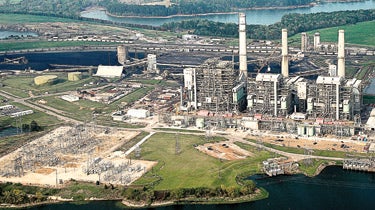

The Monticello Steam Electric Station (Figure 1), comprising three supercritical units collectively rated at 1,880 MW (net), is located in northeast Texas, just southwest of the city of Mount Pleasant and about 120 miles east of Dallas. Monticello Units 1 and 2 are each rated at 565 MW and are powered by a Combustion Engineering boiler and a Westinghouse turbine-generator. They came on-line in 1974 and 1976, respectively. Steam conditions are 3,500 psi and 1,005F. Unit 3, rated at 750 MW, is powered by a Babcock & Wilcox boiler and a turbine-generator from General Electric. Unit 3, with identical steam conditions, went into service in 1978.
1. Ten-year test bed. Monticello Steam Electric Station has been blending PRB coal with Texas lignite since 1995. Courtesy: TXU Power

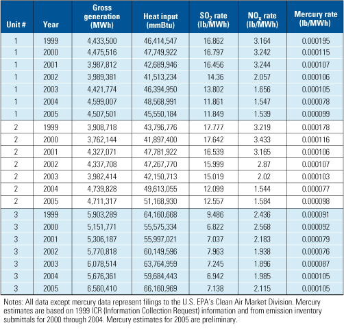

Significantly, the increasing share of PRB coal in the fuel mix slowly but surely reduced Monticello's emissions of pollutants, including mercury (Table 3). The positive, downward trends were a key reason that TXU Power's parent, Dallas-based TXU Corp., recently proposed building 11 new coal- or lignite-fired units in Texas (including Monticello Unit 4) with a total capacity of 9,079 MW by 2010—as well as another 5,000 to 8,000 MW of coal-fired capacity in the Pennsylvania-New Jersey-Maryland region (see box).
Table 3. Monticello's production and environmental performance over the past seven years. Source: TXU Power
