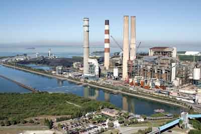

The project had its origin in December 1999, when Tampa Electric became the first utility in the nation to reach an agreement with the U.S. Environmental Protection Agency and the U.S. Department of Justice to resolve the federal agencies’ pending enforcement actions for alleged violations of the New Source Review requirements of the Clean Air Act. The resulting consent decree outlined a compliance plan to significantly decrease overall emissions from the company’s power plants. A key part of the plan was the installation of equipment to significantly reduce NOx emissions at BBPS by 2010. The reduction plans included converting Units 1, 2, and 3 from pressurized furnaces to balanced draft furnaces, comprehensive burner and windbox modification, overfire air changes, as well as adding SCR systems on each of the four coal-fired units (Figure 1).
1. Go big or go home. Tampa Electric’s Big Bend Power Station (BBPS) will soon complete its fourth selective catalytic reduction system upgrade project in as many years. When complete, NOx emissions at BBPS will have been reduced by approximately 90% from 1998 levels. Flue gas desulfurization systems also remove 95% of the SO2 from the four coal-fired units. Courtesy: Tampa Electric

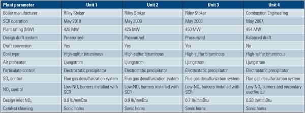

Big Bend unit details. Source: Tampa Electric

BBPS consists of four pulverized coal – fired units, built from 1970 through 1983. Each unit fires a blend of high-sulfur midwestern bituminous coal and up to 20% petroleum coke. The sulfur content of the fuel blends is typically limited to produce no more than 5.4 lb/mmBtu of SO2. Typical of coal-fired plants of this vintage, the units were equipped only with modest forms of pollution control at the time of construction. Flue gas desulfurization, also known as scrubber technology, has been in use at Big Bend since 1985, when it was first installed on Unit 4. In 1995, the Unit 4 scrubber began scrubbing Unit 3 as well. Scrubbers for Units 1 and 2 began operation at the end of 1999. The SCRs for all four units were designed for outlet NOx levels that would ensure 30-day rolling average compliance under virtually all anticipated operating conditions and to assist in catalyst life longevity (see table).
