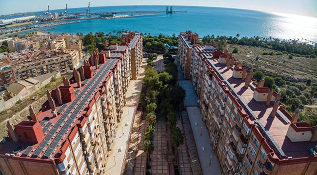

A parallel international example, perhaps, comes from Iberdrola’s 2019-launched Solar Communities program (Figure 1), which recognizes that more than two-thirds of Spain’s population “lives in high-rise buildings.” Iberdrola’s program has achieved remarkable scale, reaching 1,000 solar communities by April 2025 and serving more than 100,000 families across Spain. “In Spain, Iberdrola’s Solar Communities program allows residents to access solar from shared installations on public or commercial rooftops within about two kilometres of their homes. Participants sign up online and immediately share in the output, with savings of around 30% reported across more than 1,000 communities serving over 100,000 households,”  Monaghan explained. The Iberdrola program operates through two models: customer-owned installations where residents collectively invest, and Iberdrola-investment communities where the company owns the panels and allows digital subscription. Madrid leads with 170 installations, followed by Valencia with 148, while Extremadura hosts over 19,000 participating families.
1. The Palmeral solar community in Alicante, Community of Valencia. Iberdrola España’s network of more than 1,000 shared solar communities now supplies renewable energy to more than 100,000 households across Spain, cutting bills by up to 30% and avoiding 640 metric tons of carbon dioxide per site over 30 years. Courtesy: Iberdrola
