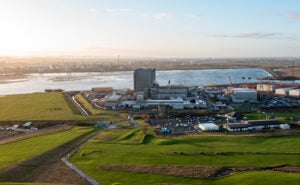

EDF will extend the lifetimes of two UK nuclear power plants—Heysham 1 in Lancashire and Hartlepool in Teesside—by an additional 12 months to March 2028 in a bid to secure the country’s energy security as it faces a looming nuclear capacity cliff and heightened reliance on imported gas.
The French-owned utility confirmed that 1.2-GW Heysham 1 in Lancashire and 1.2-GW Hartlepool in Teesside will continue generating beyond their previously scheduled March 2027 shutdown dates. The decision, which was finalized following EDF executive board meetings on Sept. 1, was based on “positive results” from nine months of graphite core inspections at both facilities.
