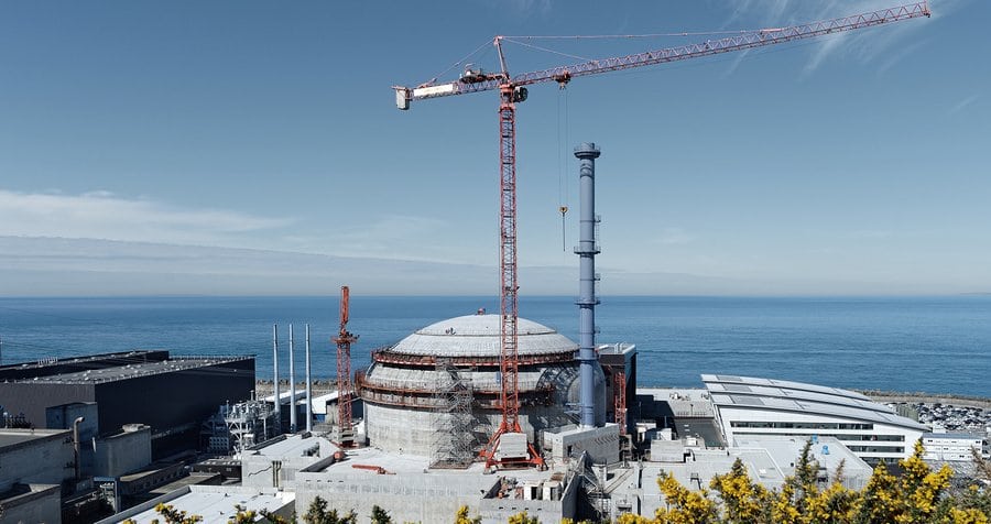

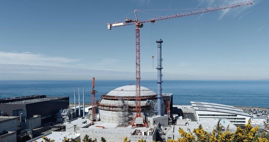

Flamanville 3 in France—another EPR—is also behind schedule and over budget. Work on that unit began in 2007 with commercial operation projected in 2013. EDF, the plant owner, recently got some good news for a change. The reactor vessel head, which had been under scrutiny due to anomalies in the composition of the steel, was approved for use through the end of 2024 by the French nuclear regulator. EDF said cold tests would begin in December and hot tests would follow next July, with commercial operation now expected in late 2018.
