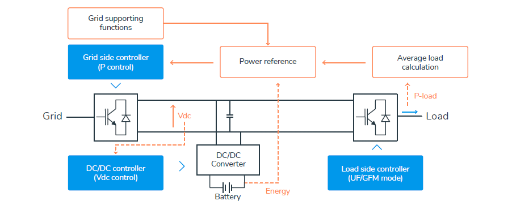

By reconfiguring the UPS system (Figure 1) to provide stability from both the grid- and load-side converters and pairing it with a continuously running battery, we could essentially prevent fluctuations in power consumption from the grid. This configuration allows for much better control of power and only requires the typical control functions used in converters.
1. Proposed UPS configuration: A double conversion type UPS with a grid-side converter, load-side converter, and battery DC/DC converter. Source: Ramboll
Turning UPS Systems Into Grid-Stabilizing Devices
In the typical configuration, a UPS battery kicks in as the grid voltage drops, and the grid-side power consumption cuts off. Then when the grid voltage recovers, the battery transfers the load back to the grid with a delay. However, the proposed reconfiguration, when paired with a continuously running battery, would eliminate the need for consumption cut off and allow for smooth power and ride-through during times of disruption.
At its core, the reconfiguration is a double conversion type UPS with a grid-side converter, load-side converter, and battery DC/DC converter. The battery sits in the middle of the system and continuous helps to balance power by either supplying or absorbing excess power. The battery essentially acts as a buffer between the grid and the data center.
On the data center side (the load side), the converter manages voltage and frequency regulation, ensuring that the facility receives steady, regulated power to protect the IT equipment from the effects of fluctuations. Meanwhile, the grid-side converter controls the flow of power, helping to smooth demand changes and support stability.
With further modifications, this system could be used for grid-support functions, acting as a stabilizing power source that sets the rhythm for the electrical system. If necessary, grid forming control functionalities can be introduced for the grid side converters to reinforce the support further. With the right controls, the proposed configuration could help manage voltage, reactive power, frequency response, ride-through during grid faults, harmonics, and electrical oscillations.

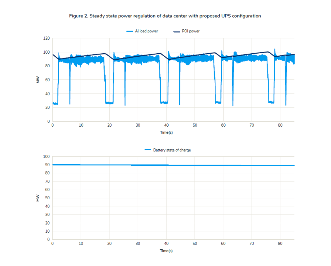

To demonstrate viability, my colleagues at Ramboll and I developed a test system featuring an AI data center training load profile with a peak load of about 100 MW. The UPS model had a total rated power of 120 MW, supported by a battery with a total capacity of 120 MWh (one hour of rated power supply). The grid-side converter operated in “grid-following” mode, where the battery follows the grid’s existing voltage and frequency, with both active power control and reactive power control (Q = 0).
The active power consumption at the load-side and grid-side converters are shown in Figure 2.
The test showed that the UPS absorbed the major load fluctuations and high-frequency ripples and kept the power draw smooth and gradual. For the small simulation time window, the state of charge (SOC) of the battery was kept almost at 90%. If necessary, the grid-side power can be kept even smoother by allowing a larger energy fluctuation in the battery.

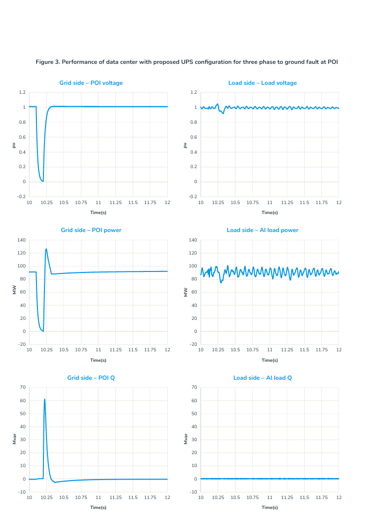

Figure 3 shows the system performance for a 100-millisecond, three-phase-to-ground fault at the interconnection point. The results showed no significant interruption on the load side, indicating that the proposed configuration maintained stable power throughout the disturbance. The grid side converter recovered well after the disturbance; similar to a well-designed BESS system.
