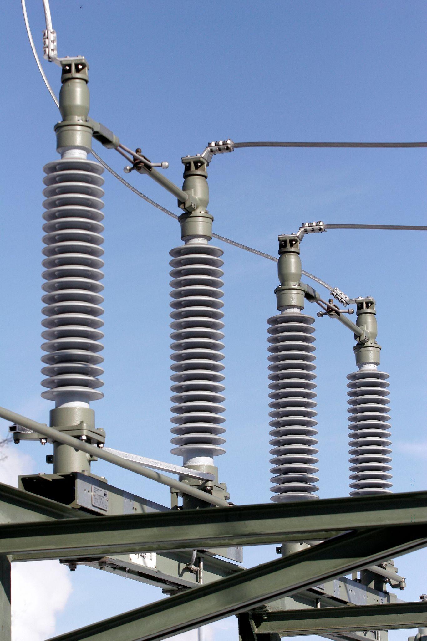

1. Silicone-housed high-voltage components operate in outdoor environments where moisture, ultraviolet (UV) exposure, temperature changes, and contamination can influence long-term surface performance. Courtesy: WACKER

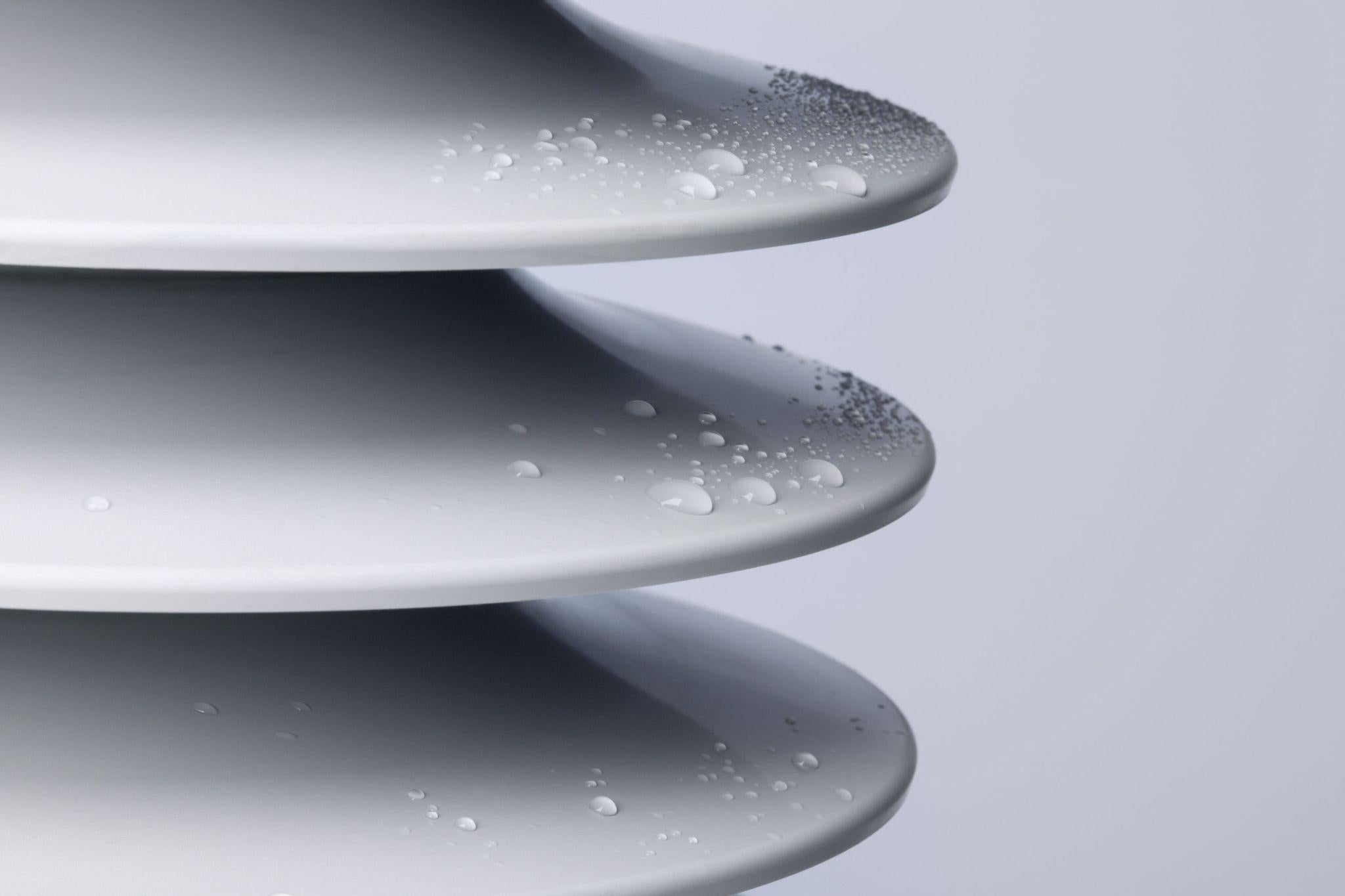

Surface wetting behavior deserves attention alongside voltage class, mechanical loading, and geometry. Hydrophobic materials encourage water to form droplets rather than spread readily into a continuous film, which can interrupt conductive pathways across the surface. Current IEC guidance for high-voltage polymer insulators used in polluted conditions recognizes hydrophobicity-transfer materials as a factor in selection and dimensioning, reinforcing the role that surface behavior can play in contaminated environments.
Silicone elastomers have become established materials for outdoor high-voltage applications because their surface characteristics can support hydrophobic behavior (Figure 2) while the material also offers resistance to ultraviolet exposure, ozone, and weathering. Those properties do not replace sound equipment design, qualification, inspection, or maintenance. They influence how the exposed surface responds to the environment around it, which becomes especially relevant where contamination and moisture repeatedly occur together.
2. Water beads on a hydrophobic silicone insulator surface, helping limit the formation of continuous moisture films that can contribute to leakage current under contaminated conditions. Courtesy: WACKER

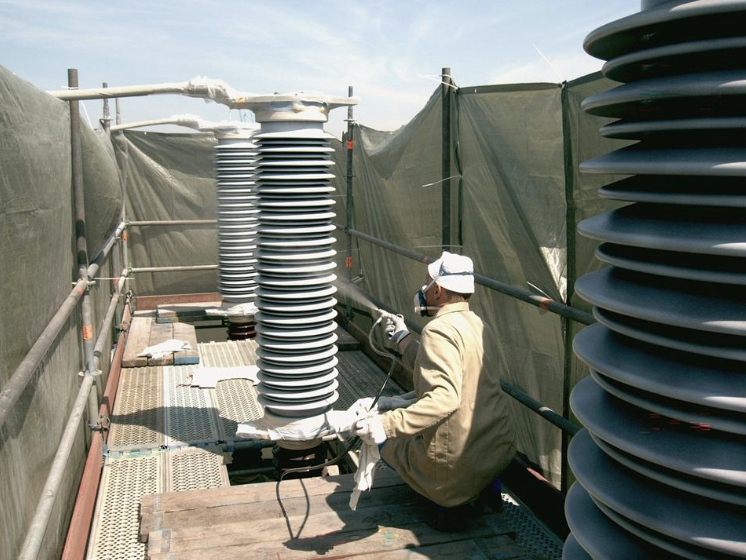

Room-temperature-vulcanizing silicone coatings provide an established option for improving the surface characteristics of porcelain and glass insulators. The coating creates a hydrophobic silicone surface over the ceramic substrate, changing the way water interacts with contamination on the insulator. This can help reduce the formation of continuous conductive moisture films in wet or polluted environments, giving utilities another way to address recurring surface-performance concerns when the underlying insulator remains suitable for service.
The appeal comes from matching the intervention to the mechanism. If an insulator remains suitable for service but operates where wet contamination creates recurring performance or maintenance concerns, an RTV silicone coating can provide hydrophobic surface behavior without replacing the entire component solely to change that characteristic (Figure 3). This approach can give asset owners another option between repeated cleaning and full replacement when the underlying equipment remains fit for service.
3. A technician applies a silicone coating to existing high-voltage insulators, creating a hydrophobic surface that can help improve performance in wet or contaminated environments. Courtesy: WACKER
A coating also has clear boundaries. It cannot correct mechanical damage, deficient equipment design, compromised hardware, or an asset that no longer meets system requirements. Surface preparation, application quality, coating condition, and the severity of environmental and electrical stress all influence long-term performance, which is why utilities should treat coating selection, application, and evaluation as engineering decisions rather than cosmetic maintenance steps.
