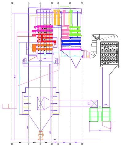

The features and arrangement selected for the A-USC steam generator are very likely to evolve from the current state-of-the-art two-pass arrangement (Figure 2).
2. Current state-of-the-art 600C USC. Source: B&W

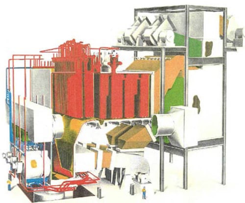

The tower design used in Europe, the ranch-style (Figure 3) and the modified tower design, which is a combination of the two-pass and tower designs, are also under consideration (Figure 4).
3. AEP Philo 6 universal pressure steam generator. Source: B&W
4. Conceptual design 800-MW modified tower A-USC. Source: B&W
The two-pass design shown in Figure 2 is considered to have the following advantages:
  • Shorter steel structure than a tower design.
  • Time savings of parallel construction sequence.
  • Less complicated high-temperature tube sections support.
  • More economical to erect.
  • Less sootblowing required to clean the pendant surfaces than high-temperature horizontal surfaces in the tower design.
The tower design (Figure 3) is considered to have the following advantages:
  • Better gas flow distribution resulting in lower tube metal upset temperatures.
  • Wider tube spacing allowing high fuel ash removal to a single furnace hopper.
  • Ability to successfully fire brown lignite.
  • Drainable heating surface.
The modified tower design combines features of both designs: the structure is shorter than the tower design, and steam leads are shorter and nearer to the steam turbine. The ranch style design (Figure 3) has short steam leads, while requiring a more horizontal footprint and long ash hopper system.
Both the two-pass and tower designs have found success and enjoy preferences in select applications. Countermeasures for the negative aspects of these designs have been incorporated that keep the designs viable in the market place.
