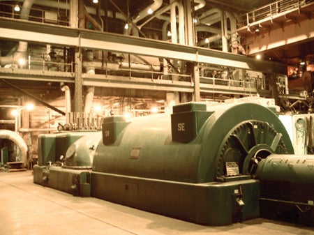

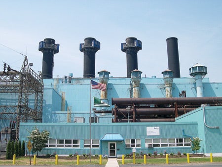

Exelon Power's Fairless Hills Generating Station (Figure 1) is a two-unit, 60-MW power plant purchased in 1997 from USX Corp. (then known as U.S. Steel). It recently was reconfigured to burn captured landfill gas, rather than its design fuels—oil, natural gas, and waste gases from an adjacent USX steel plant. Each of the plant's boilers supplies 300,000 lb/hr of steam at 850 psi and 900F to its turbine-generator (Figure 2).
1. Old dog, new tricks. The 60-MW Fairless Hills Generating Station was recently repowered to burn landfill gas. Courtesy: Exelon Corp.
2. Aging gracefully. The plant's two 30-MW steam turbines were originally installed in the 1950s. Courtesy: Exelon Corp.
