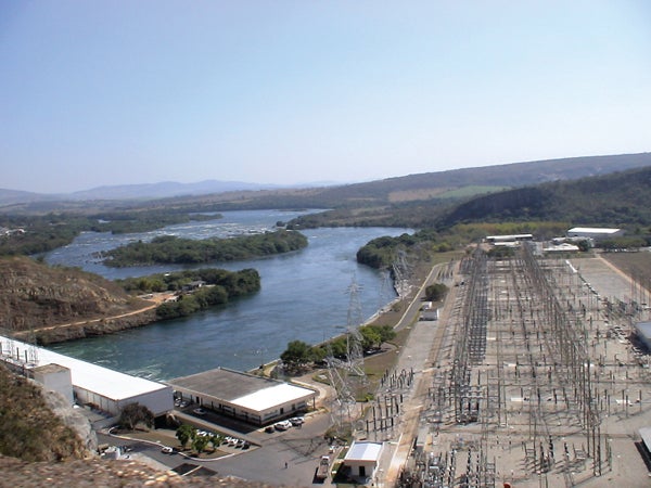

6. Hydropower emissions. Hydropower reservoirs like the UHE FURNAS one owned by Brazilian utility FURNAS may not emit as much greenhouse gas as had been previously suggested, a new analysis shows. Located in the middle of the Rio Grande, the UHE FURNAS reservoir is one of the largest in Brazil. It impounds the Grande River and has a capacity of 22,590,000,000 cubic meters (18,314,011 acre feet) and a surface area of 1,473 square kilometers (569 square miles). Courtesy: FURNAS
