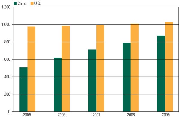

1. Runaway capacity. China’s installed power capacity has nearly doubled in the past five years, signifying exponential growth of its power sector. Installed capacity for 2010 is estimated to exceed 900 GW. For comparison, the installed capacity of the U.S. as of June 2010 is approximately 1,030 GW. Sources: China Electricity Council, State Grid Corp. of China, U.S. Energy Information Administration

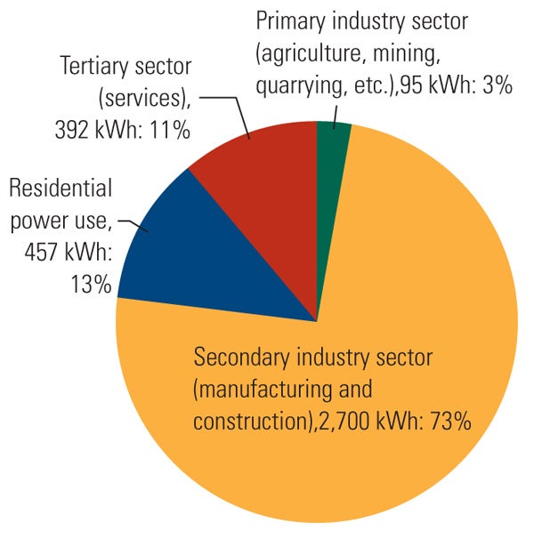

2. Who consumes China’s power? China’s power consumption shot up 6% last year, compared to 2008, to 3.643 trillion kWh, spurred by a ¥755.84 billion (US$110.67 billion) investment (nearly 20% more than the year before). By the end of 2009, the country’s installed power generation capacity, shown here, was 874.07 GW, an annual increase of 10%. Already in the first four months of 2010, increased consumption (on average 25% per month year-on-year) has been met by increased oil- and coal-fired generation. Officials point out that this not only indicates that the economy is rebounding but also that industrial activity has rebounded. Boosts are particularly attributed to a stimulus-incented increase in public works construction, which requires much steel and cement. Sources: China National Energy Administration, National Bureau of Statistics
