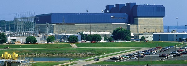

1. Full service. With the 2007 restart of Unit 1, Tennessee Valley Authority’s three-unit Browns Ferry Nuclear Plant is now back in full service. Source: TVA
