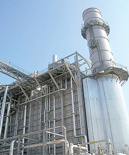

Combined-cycle plants will continue to be cycled on and off frequently as long as natural gas costs more than coal. The need to start a plant's gas turbine quickly—to meet short-term electricity demand—sometimes overshadows the potential effects of cycling metal temperatures of heat-recovery steam generator (HRSG) tubes and those of superheater and reheater headers. In particular, the combined effect of this thermal cycling on water and steam chemistry can be significant.
A metallurgical penalty must be paid each time an HRSG goes through a thermal cycle. Many of the physical damage mechanisms have been addressed in POWER (October 2002; March, April, and September 2004; and March 2006) since the boom in combined-cycle plant construction began over a decade ago (Figure 1).
1. Fast mover. Heat-recovery steam generators like this one are now cycled often, sometimes daily, to meet swings in demand. Water chemistry has to keep up with changes in HRSG operating conditions. Courtesy: David Daniels
