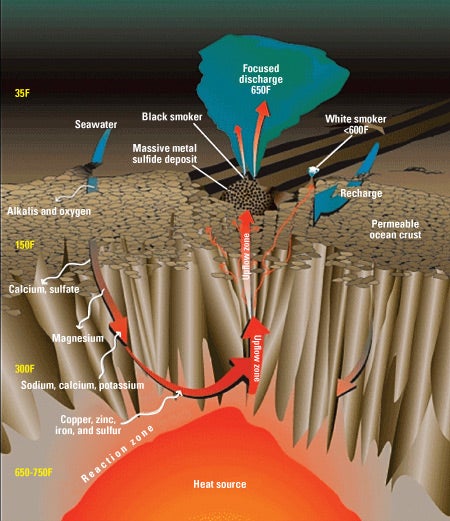

Not all geothermal projects have a finite life, at least not as we normally characterize finite. Southern California inventor Bruce C. Marshall (www.marshallsystem.com) laments the lack of attention paid to a huge untapped renewable energy source—hydrothermal vents on the ocean floor. Magma from deep within the earth is constantly pushing its way to the surface, forcing the planet’s tectonic plates apart. As two plates separate, the rock below them partially melts to produce magma that rises and fills the gap and produces further seafloor spreading (Figure 1).
1. What lies beneath. Ridges are formed as tectonic plates pull away from each other, forming hydrothermal vents along the boundary. Source: U.S. Geological Survey

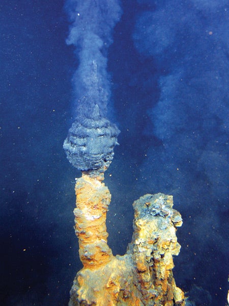

Tectonic plate movement opens fissures on the seafloor into which seawater is forced down by the high pressure of the water column above it. Magma superheats the seawater to a temperature as high as 750F, creating a geyser (an underwater version of Old Faithful) with a velocity of 3 to 15 feet per second (fps). Because the pressures at depth are up to 3,200 psi, the hot fluid stream doesn’t flash into steam. But the cold surrounding seawater causes a cocktail of metals and minerals to precipitate out of the fluid and rain down on the seabed. Precipitates include iron, gold, silver, copper, and zinc, to name a few elements (Figure 3).
3. Thank you for smoking. Plumes from sites on the ridge crest are often caused by the intrusion of a magma dike during an episode of seafloor spreading. The hot fluids rise and are diluted by the surrounding seawater. Courtesy: U.S. Geological Survey
