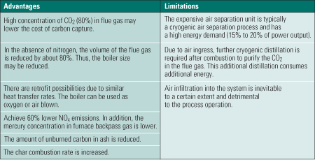

In the Rankine steam cycle with oxyfuel combustion, the volume of flue gas leaving the boiler is considerably smaller than the volume of air entering it. Why? The large amount of N2 in combustion air (78%) does not become part of the flue gas. As a result, the volume of flue gas from an oxyfueled plant is about 75% lower than that from a plant using air for combustion. The flue gas from an oxyfueled plant consists primarily of CO2. Figure 1 shows a block diagram of a typical oxyfuel process, and Table 1 highlights its advantages and limitations.
1. A typical oxyfuel combustion block diagram. Source: Bechtel Power Corp.
Table 1. Oxyfuel combustion’s pluses and minuses. Source: Bechtel Power Corp.

At the heart of the oxyfuel process is an air separation unit (ASU), a large vessel that consumes much electricity. In an effort to reduce its load and penalty on plant output, new, more energy-efficient oxygen separation technologies are in development. They include ion transport and oxygen transport membranes and BOC Group’s ceramic autothermal recovery process for oxygen production.
