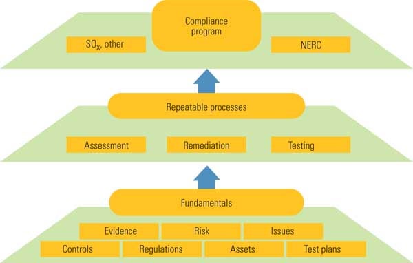

Compounding the breadth of the reliability standards is their relative newness — and potential financial impact. Despite its 40-year history, NERC has only had the authority to enforce reliability standards and assess fines for noncompliance since June 2007. The current audit cycle represents the first year that organizations face significant monetary fines for noncompliance, and though the initial fines have been relatively small, the maximum fines are one million dollars per violation, per day. In addition to the financial penalty, violations are publicly reported, representing potential damage to an organization’s reputation (Figure 1).
1. Pass your audit. The North American Electric Reliability Corp. reliability standards consist of a broad set of requirements, ranging from technical controls on the quantity and quality of electricity supplied to the grid to administrative procedures for personnel and staffing. The 14 standards each consist of multiple specific requirements, resulting in 94 mandatory reliability standards, each of which has several audit items, which a comprehensive compliance program
