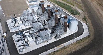

Austin Energy (AE) owns the Sand Hill Energy Center (SHEC), a 500-MW power plant with a natural gas combined-cycle unit and four simple-cycle peaking combustion turbines. With typical high summer demands for the growing Austin area and record electric peaks in 2009, SHEC relies on its four General Electric LM-6000 combustion turbines for on-demand capacity. Those turbines together experience approximately 350 start/stops per year. As shown in Figure 1, each combustion turbine has a dedicated selective catalytic reduction (SCR) unit for NOx reduction to meet the plant’s stack emission permit limits.
1. Four peakers. Austin Energy’s Sand Hill Energy Center includes four 50-MW simple-cycle combustion turbines for peaking service that are equipped with SCRs. Also present on the plant site is a 480-MW combined-cycle plant. Work is under way to add two additional 50-MW peaker combustion turbines with start-up scheduled later this year. Courtesy: NEPCO

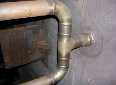

In addition, an initial inspection of the AIG lances revealed that the injection holes were 12 inches from either side of the duct walls (Figure 2). This injection gap was causing a starvation of ammonia to a portion of the flue gas stream, thereby permitting flue gas to pass through the SCR system essentially untreated.
2. Just passing by. An inspection of the ammonia injection grid lances found that ammonia was not thoroughly mixing with the flue gas, thereby allowing a portion of the gas stream to pass through the catalyst untreated. This figure illustrates a “two-prong” ammonia injection grid design (AIG). Courtesy: Cormetech

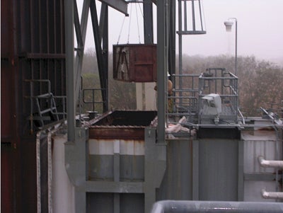

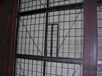

During the December 2007 outage, turnkey SCR catalyst replacement was completed in less than two weeks, with 12 new custom-designed modules installed within each of the four units (Figure 3). For each unit, a sample tray was incorporated to allow for easy removal of catalyst samples for evaluation, as shown in Figure 4. During future outages, the samples can be quickly removed and a replacement catalyst element installed. The sample is then returned to Cormetech for analysis and to assist with catalyst management planning. This approach precludes the need for rigorous drilling of the catalyst to extract core samples.
3. Complete replacement. The SCR assemblies for all four combustion turbines were replaced in less than two weeks during the December 2007 outage. Courtesy: Cormetech
4. Process improvement. A sample tray was added to each of the new catalysts to ease access when collecting catalyst core samples for laboratory analysis. Drilling of the catalyst to collect a sample is no longer required. Courtesy: Cormetech
