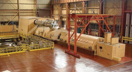

1. Smooth operator. Southern Company’s Plant Branch Unit 2 is a 320-MW GE steam turbine. The unit began commercial operation in 1967. Courtesy: Southern Company Generation

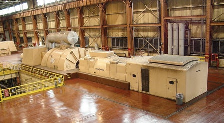

2. Making power. Unit 4 at Southern Company’s Plant Branch is a 500-MW Westinghouse steam turbine that began operation in 1969. Courtesy: Southern Company Generation
