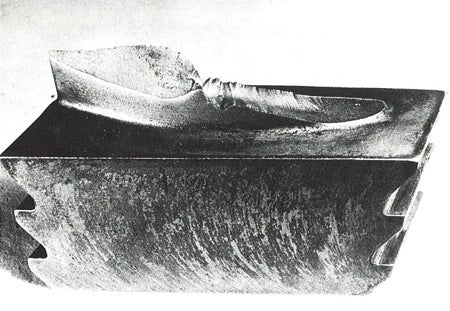

1. Gone but not forgotten. Stress corrosion at the blade base caused this blade failure. Courtesy: Sermatech International Inc.

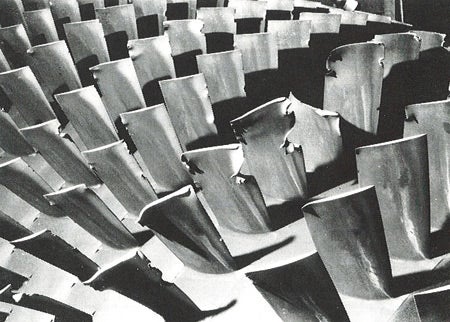

2. Trickle-down theory. Many downstream blades are damaged by a single liberated airfoil. Courtesy: Sermatech International Inc.
Coating failure can quickly lead to blade failure due to stress corrosion, pitting, and catastrophic failure (Figure 1). Fatigue failures invariably originate with corrosion pits forming a stress riser from which a crack propagates—ultimately resulting in blade failure (Figure 2).
