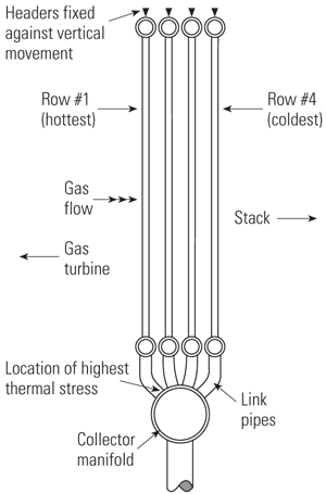

The second superheater/reheater coil-configuration option (Figure 2, p. 40) is one commonly seen in the field. Here, each tube row is supported from above by its own fixed header, and link pipes connect the lower headers to a collector manifold. In this configuration, the maximum thermal stresses are at the bends in the link pipes. This layout does not lend itself well to cycled HRSG operation because components cannot move freely relative to each other. Absorption of row-to-row temperature differentials depends entirely on the flexibility of the coils and the link pipes and rotation of the manifold.
2. Too reliant on flexibility. This superheater/reheater coil configuration has fixed upper and lower headers.Source: Nooter/Eriksen Inc.

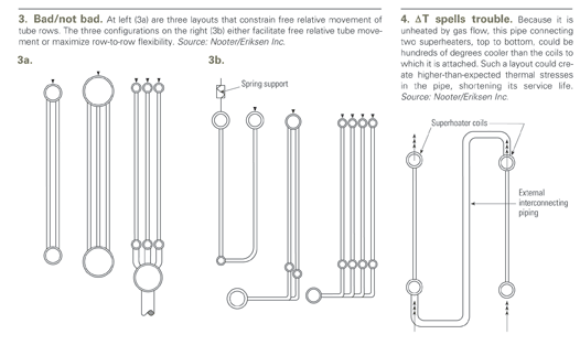

To wrap up this discussion, Figure 3 illustrates some bad and good superheater/reheater coil configurations. None of the three layouts shown in Figure 3a can cope with row-to-row differentials in the magnitude or rate of thermal expansion. In all three cases, the tube rows cannot move freely relative to each other because they are tied together, either by upper and lower headers or a manifold. It's worth noting that, although these layouts work well in evaporators (where row-to-row temperature differentials are very small), they leave superheater and reheater tubes vulnerable to cycling-induced thermal fatigue.
3. Bad/not bad. At left (3a) are three layouts that constrain free relative movement of tube rows. The three configurations on the right (3b) either facilitate free relative tube movement or maximize row-to-row flexibility.Source: Nooter/Eriksen Inc.
For contrast, note how the three configurations in Figure 3b either facilitate free relative tube movement or maximize row-to-row flexibility. In the example on the left, the outlet header is supported by a spring, allowing the header to move up or down depending on the temperature difference between the two rows. The other two examples feature long horizontal pipe runs that allow the lower headers to move easily relative to one another.
Interconnecting piping. During HRSG start-up, it is not uncommon for the pipes not heated by gas flow that interconnect superheaters and reheaters to be hundreds of degrees (Fahrenheit) cooler than the coils to which they are attached. In normal operation, the temperature differential between the piping is much smaller and might be accommodated by the piping's flexibility. Nonetheless, it is important that the layout of interconnecting piping consider the start-up differences. Figure 4 shows a configuration that connects the top of the superheater coil on the right to the bottom of the coil on the left.
4. T spells trouble. Because it is unheated by gas flow, this pipe connecting two superheaters, top to bottom, could be hundreds of degrees cooler than the coils to which it is attached. Such a layout could create higher-than-expected thermal stresses in the pipe, shortening its service life.Source: Nooter/Eriksen Inc.
