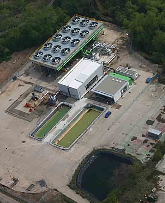

On Aug. 15, just after 2 p.m. on a Saturday, an earthquake registering 2.7 on the Richter scale rocked the German city of Landau in the province of Rheinland-Pfalz, close to the French border. Residents reported hearing a loud boom, prompting more than 200 calls to the local police. No damage or injuries were reported, but shockwaves of panic began to radiate throughout the country — and beyond.
Alarm spread as the state geological survey for Rheinland-Pfalz claimed the epicenter of the quake was centered 450 meters (500 yards) from a novel geothermal plant’s drilling site, at about 3.3 km (2 miles) underground — the same depth at which the steam reservoir from which the plant was drawing heat lay (Figure 1). It was the first time tremors had been felt from the commercial plant commissioned in late 2007. One of the first of its kind, the €15.5 million ($23.2 million) enhanced geothermal system (EGS) project had been sponsored by Germany’s environment ministry, and it provided 3.2 MW of power and heat to a district-heating scheme. It also benefited from the country’s feed-in-tariff program.
1.     Shaken up. This August, a 2.7-magnitude temblor rocked the German city of Landau, close to the French border. Because it was centered on one of the first commercial enhanced geothermal systems in the world, the quake triggered concerns about the novel technology and its seismic risk. Courtesy: Geox

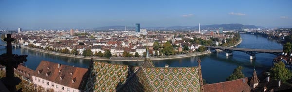

The Landau shake-up was even compared to a 3.4-magnitude trembler that shook residents, put cracks in buildings, and shattered roof tiles in Basel, Switzerland, on Dec. 8, 2006. The city of medieval cathedrals (Figure 2) is built in the region of that country that is most prone to seismic activity. Switzerland already sees three or four quakes of that size a year, but Basel was particularly vulnerable, officials said in 2006, having been leveled by a 6.5-magnitude earthquake once before, in 1356. Geopower Basel, the company that had been executing a trial deep heat mining project within the city — at Neuhaus Street and Shafer Lane — admitted that high-pressure injection of water 5 km into underlying superheated rocks could have caused the event. Authorities immediately halted the project, pending findings of a detailed seismic risk study, the results of which are due this December.
2.     Basel rocks. On Dec. 8, 2006, a trial enhanced geothermal systems (EGS) project within the city of Basel, Switzerland, triggered a 3.4-magnitude quake that cracked buildings, shattered roof tiles, and made waves around the world. On average, Switzerland experiences three or four earthquakes of that size per year, but Basel is particularly vulnerable, having been leveled by a 6.5-magnitude quake in 1356. Courtesy: Wikimedia Commons
