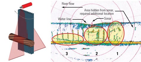

Scanning sonar can work in either imaging or profile mode. In the former case, the images delivered can be used to make subjective assessments of the integrity and fouling of bridge piers, cooling water intakes, and dam walls (Figure 1). But because the images are two-dimensional, they cannot be used to identify the location of debris or damage in the third dimension, or its extent. In order to quantify the volume of debris or the extent of scour, measurements must incorporate survey points that are known in three dimensions so that volumetric calculations can be made.
1. Scanning sonar in imaging mode. This mosaic was made from imaging scans showing possible debris locations. The extent of the debris in the third dimension (toward and away from the viewer) cannot be determined from this type of survey. Source: ASI Group Ltd.

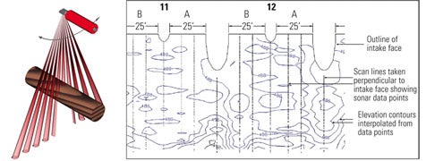

A scanning sonar system configured for profiling instead of imaging (Figure 2) can obtain the third set of coordinates, producing something akin to a relief map. Setting up the sonar at several locations enables collection of enough survey points to cover the desired area. If the process is properly done, it takes much longer to do the setups than the scans.
2. Scanning sonar in profiling mode. A bathymetric plot made by interpolating several profiling scans perpendicular to the intake face. Enough scans at different locations were done to provide 1,200 data points. Source: ASI Group Ltd.
A big benefit of using dual-axis scanning sonar is that it allows the position of the scanning head to be fixed at one or more known locations. Realize that if the head moves due to vibration or an insecure mount, the resulting measurements will be skewed unless they are extensively post-processed to correct for the positional errors. Well-designed dual-axis scanning sonar systems calibrate the readings to assist with post-processing by incorporating attitude sensors for measuring pitch, roll, and possibly yaw or heading.
