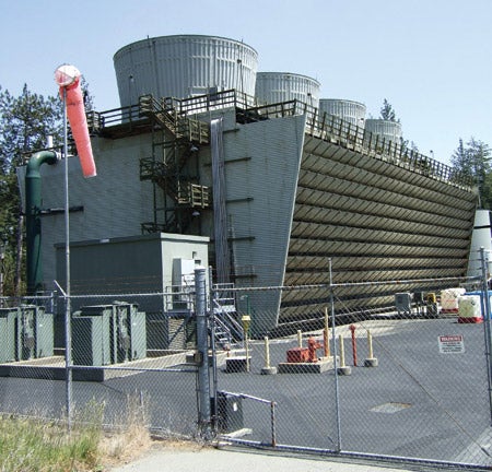

6. California power flex. California, which led U.S. states in total on-line geothermal capacity in August, is gearing up for 20 new projects with a total capacity of about 1,016.6 MW. The state is home to several spectacular plants, including The Geysers, a project consisting of 22 separate power plants that produce about 750 MW. Shown here is a Geysers plant, the 24-MW West Ford Flat, in Middletown, Calif. Courtesy: Calpine Corp.
