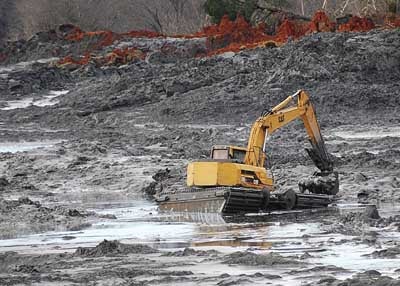

Initially, the TVA and the Environmental Protection Agency (EPA) had estimated the spill released 1.7 million cubic yards of coal ash, but in the days ensuing, the official estimate soared to 5.4 million cubic yards — double that said to be contained in the pond (Figure 1). Officials said that heavy rains and freezing temperatures could be to blame for the discrepancy: On that winter night, temperatures for the region had plunged to 14F, and the plant had received an unseasonable total of 6.48 inches that month.
1. Ash Thursday. On Dec. 22, 2008, the earthen retaining wall of an ash pond for the Tennessee Valley Authority’s 1955-built Kingston Fossil Plant failed, spilling 5.4 million cubic yards of fly ash and bottom ash. More than 60 pieces of large equipment, such as the amphibious trackhoe picture here, have been used to remove the ash from roadways and railroad tracks near the Tennessee plant. Source: TVA
