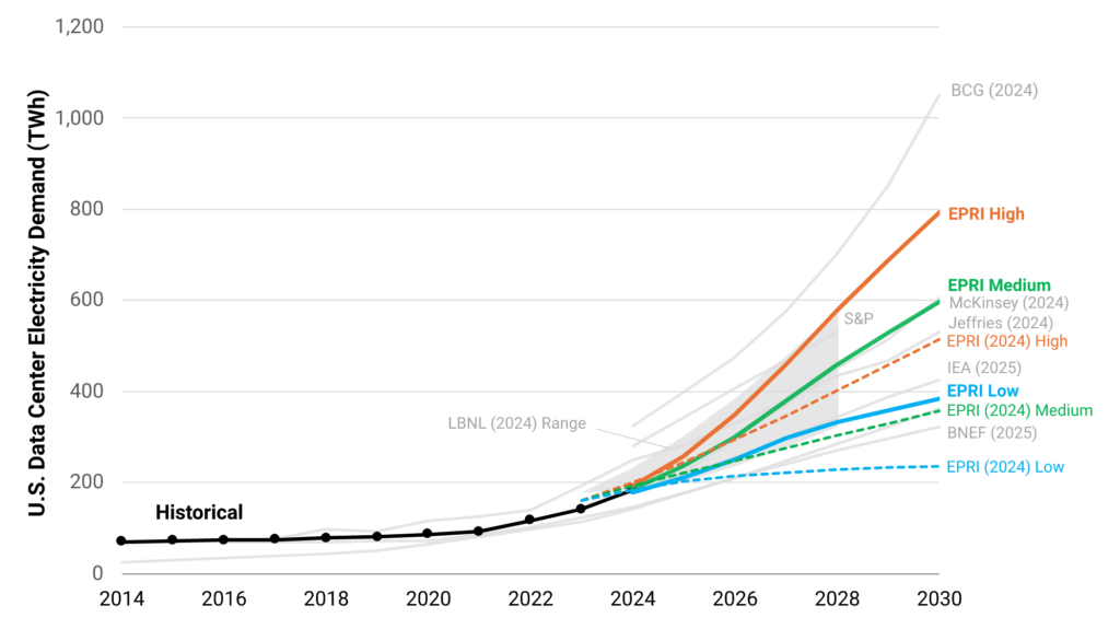

U.S. data center electricity demand is projected to reach 380 to 793 TWh annually by 2030, up from an estimated 177 to 192 TWh in 2024, according to EPRI's February 2026 Powering Intelligence report. EPRI's updated high-growth scenario (orange) is roughly 60% above the research organization's own 2024 projections, reflecting the accelerated pace of data center development over the past 18 months. The wide scenario range—low (blue), medium (green), and high (orange)—reflects uncertainty around whether projects currently in early planning stages can overcome power supply, supply chain, and permitting constraints by 2030. For comparison, prior forecasts from BCG, McKinsey, Jefferies, S&P, IEA, LBNL, and BNEF are shown in gray. Source: EPRI, Powering Intelligence: Updated Scenarios of U.S. Data Center Electricity Use and Power Strategies, February 2026.
U.S. data center electricity demand is projected to reach 380 to 793 TWh annually by 2030, up from an estimated 177 to 192 TWh in 2024, according to EPRI’s February 2026 Powering Intelligence report. EPRI’s updated high-growth scenario (orange) is roughly 60% above the research organization’s own 2024 projections, reflecting the accelerated pace of data center development over the past 18 months. The wide scenario range—low (blue), medium (green), and high (orange)—reflects uncertainty around whether projects currently in early planning stages can overcome power supply, supply chain, and permitting constraints by 2030. For comparison, prior forecasts from BCG, McKinsey, Jefferies, S&P, IEA, LBNL, and BNEF are shown in gray. Source: EPRI, Powering Intelligence: Updated Scenarios of U.S. Data Center Electricity Use and Power Strategies, February 2026.
However, what is most testing utilities’ ability to keep pace is that regional clusters of large loads are transforming local grid dynamics. EPRI’s data shows that concentration is accelerating in a small number of states. Virginia—already the only state where data centers exceed 20% of in-state electricity consumption—could see that share reach 39% to 57% by 2030. Under the medium-growth case, seven additional states—Oregon, Iowa, Nebraska, Nevada, Wyoming, Arizona, and Indiana—are projected to cross the 20% threshold, even as new nominal capacity builds emerge in states such as Ohio, Pennsylvania, Louisiana, and Mississippi, where developers are prioritizing power access and land availability, particularly for large AI training centers. Under current federal and state policy, EPRI’s modeling projects the supply response will run heavily on natural gas, forecasting incremental capacity additions of 6.6 GW to 13.7 GW per year from 2025 to 2030—above the five-year historical average of 5.7 GW annually—as wind and solar play a reduced role following curtailment of Inflation Reduction Act tax credits under the 2025 budget reconciliation bill.
