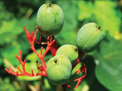

Jatropha Oil. Jatropha curcas, a plant that thrives anywhere — even in the crevices of rocks and in sandy and saline soils — produces a nonedible but high-energy seed (Figure 2). When crushed, the seeds’ oil can be processed to produce a high-quality biodiesel. The plant yields more than four times as much fuel per acre as soybean and more than 10 times that of corn.
2.    Bellyache bush. When crushed, the Jatropha curcas plant’s poisonous seeds produce a crude oil that can be used for power generation or processed into high-quality biodiesel. Courtesy: Thenergo

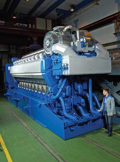

In August, the world’s first engine-driven combined heat and power (CHP) plant to run on crude jatropha oil will come online. The grid-connected plant, which will be located in an agricultural area in Merkplas, Belgium, will be owned by Greenpower NV, a joint venture between Thenergo and four agricultural companies. Finnish company Wärtsilä will supply a 9-MW Wärtsilä 20V32 engine for the project (Figure 3). The power plant is expected to have a gross electrical efficiency of 44.2%.
3.    New oil power. The first combined heat and power plant to use crude jatropha oil as fuel will come online in August this year in Merkplas, Belgium. Finnish company Wärtsilä will supply a 9-MW Wärtsilä 20V32 engine to Greenpower NV, owner of the plant. Courtesy: Wärtsilä
