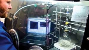

"Power plants could easily retrofit to use our process as a direct replacement for existing technology," said David Heldebrant (Figure 1), PNNL’s lead research scientist for the project, this August.
1.     An acid scrub. Pacific Northwest National Laboratory scientist David Heldebrant works to capture sulfur components and CO2 from test emissions streams in a process called reversible acid gas capture. The process could one day replace current gas-scrubbing methods while increasing the amount of the gases captured in a cost-efficient way that uses no water and less energy. Source: PNNL
