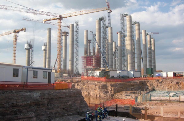

1. When it rains, it will pour. The six units at Eskom’s 4,800-MW Medupi coal-fired power plant, under construction in Lephalale, are expected to come online between 2012 and 2015. The project, with a name that means “rain that soaks parched lands, giving economic relief,” will include South Africa’s first supercritical plant. A similar 4,800-MW coal-fired plant, the Kusile, is also under construction in Lephalale, with the first unit expected to come online in 2014. That plant will be South Africa’s first plant to install flue gas desulfurization. Courtesy: Eskom
