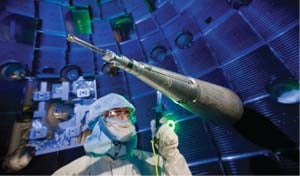

2. Precision alignment. A National Ignition Facility technician checks the target positioner, which precisely centers the target inside the target chamber before each experiment and serves as a reference to align the laser beams. Source: Lawrence Livermore National Laboratory
