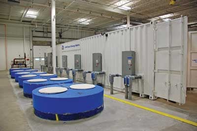

2.    Setting the flywheels in motion. Beacon Power Corp.’s engineering and production team stored and returned 1 MW of electricity through an integrated matrix of 10 flywheels in Tyngsboro, Mass. The achievement is a milestone that could bring the use of energy storage for grid regulation closer to commercial deployment. Courtesy: Beacon Power Corp.
Until now, Beacon had been building and running individual flywheels in preparation for its first full megawatt implementation. Testing of an integrated matrix of 10 flywheels at the company’s Tyngsboro, Mass., headquarters has now shown that its 1-MW Smart Energy Matrix can ramp up and down to absorb and supply a full megawatt of power, it said.
