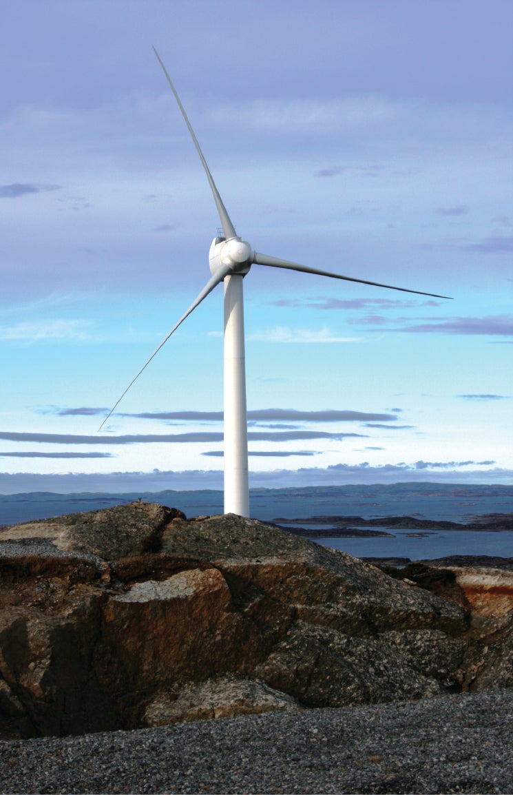

The U.S. company acquired the technology last August, when it took over the ScanWind unit of Sweden’s Morphic Technologies. As the largest wind turbine in GE’s fleet, it will incorporate advanced drive train and control technologies gained through GE’s acquisition of ScanWind, the company said. The technology is already being demonstrated at a test site in Hundhammerfjellet, Norway, where the first ScanWind direct drive unit has been operating for more than five years (Figure 2).
2. In high gear. GE in April said it would introduce a 4-MW gearless offshore wind turbine in 2012, which is based on a technology acquired from Swedish company ScanWind. The technology is already being demonstrated at a test site in Hundhammerfjellet, Norway, where the first ScanWind direct drive unit has been operating for more than five years, GE said. The new turbine is expected to up the ante for companies vying for market share in the world’s soaring offshore wind sector. Courtesy: GE
