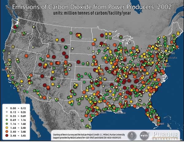

Toward that goal, last April, Dr. Gurney started the Vulcan Project (named after the Roman god of fire). According to the Vulcan web site, which includes research data and maps (www.purdue.edu/eas/carbon/vulcan/index.php), "The Vulcan project has achieved the quantification of the United States fossil fuel CO2 emissions at the scale of individual factories, powerplants, roadways and neighborhoods. We have built the entire inventory on a common 10 km grid to facilitate atmospheric modeling. Vulcan is available at the hourly timescale for the year 2002 {Figure 1]. In addition to improvement in space and time resolution, Vulcan is quantified at the level of fuel type, economic sub-sector, and county/state identification.

1. Vulcan data. This image from the Vulcan Project shows the location and magnitude of CO2 emissions from major power producers under the Continuous Emissions Monitoring program of the Emissions Trading System. The Vulcan Project is a NASA/DOE-funded effort under the North American Carbon Program to quantify North American fossil fuel CO2 emissions at space and time scales much finer than has been achieved in the past. Source: Purdue University
