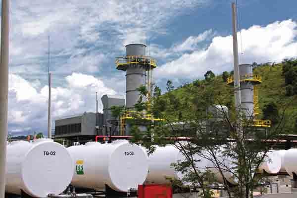

Brazil’s state-owned oil producer, Petrobras, on Dec. 31, 2009, said it had inaugurated the world’s first power plant to run exclusively on ethanol. The country that is the second-biggest producer of ethanol in the world after the U.S. installed an 87-MW plant in Benfica Industrial District, in Juiz de Fora (in the southeastern Brazilian state of Minas Gerais) (Figure 2). The plant is connected to the National Interconnected System and has supply contracts through 2020.
2. Electricity exclusively from ethanol. Brazil, the world’s second-largest producer of ethanol after the U.S., in December began operation of a power plant that runs exclusively on the biofuel. Courtesy: Petrobras

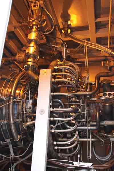

One of the plant’s two General Electric – manufactured LM6000 aeroderived turbines, which has an installed capacity of 43.5 MW, was adapted to run on ethanol (Figure 3). The conversion of the turbine involved replacement of the combustion chamber and one of the injector nozzles, and the installation of peripheral equipment (receipt system, tanks, pumps, and filters), which allows the receipt, storage, and flow of ethanol to the turbine.
3. Refurbished for renewable fuel. The Juiz de Fora Power Plant is a simple-cycle, natural gas plant with a total capacity of 87 MW, located in the south of Minas Gerais state, approximately 180 kilometers north of Rio de Janeiro. The plant has two GE LM6000 gas turbines, one of whose combustors has been modified by GE to enable the use of ethanol, making it dual-fuel (ethanol and natural gas). Courtesy: Petrobras
GE developed the new combustion chamber especially for the use of ethanol and natural gas, Petrobras said. The equipment was installed in the turbine in Brazil, at Petrobras’ Turbo Machine Workshop in Macaé. Through an agreement with Petrobras, GE is following up on the tests and will be entitled to use the data that are obtained to improve and market the technology to other plants around the world.
